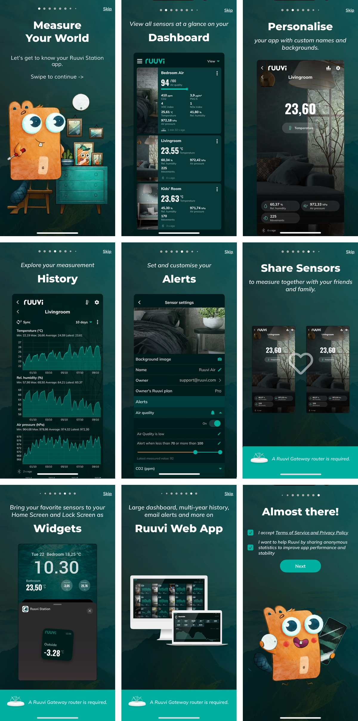

Ruuvi Station Welcome Tour (mobile)
When launching Ruuvi Station mobile app for the first time, our app will give you a short tour showing you what you can do with it. This tour will be shown only on the first launch or when updating to the next major version of the app. If Ruuvi Station app data is cleared, this tour will be presented again.
On the last page of the tour you will be shown either:
“Almost there!”,
With instructions to Create a new Ruuvi account or sign in to an existing account. Choosing Next you will be forwarded to Sign in.
“Let’s get started!”,
When you are updating the app from a previous version and you are already signed in to the app. Choosing Next you will be moved to Dashboard view.
